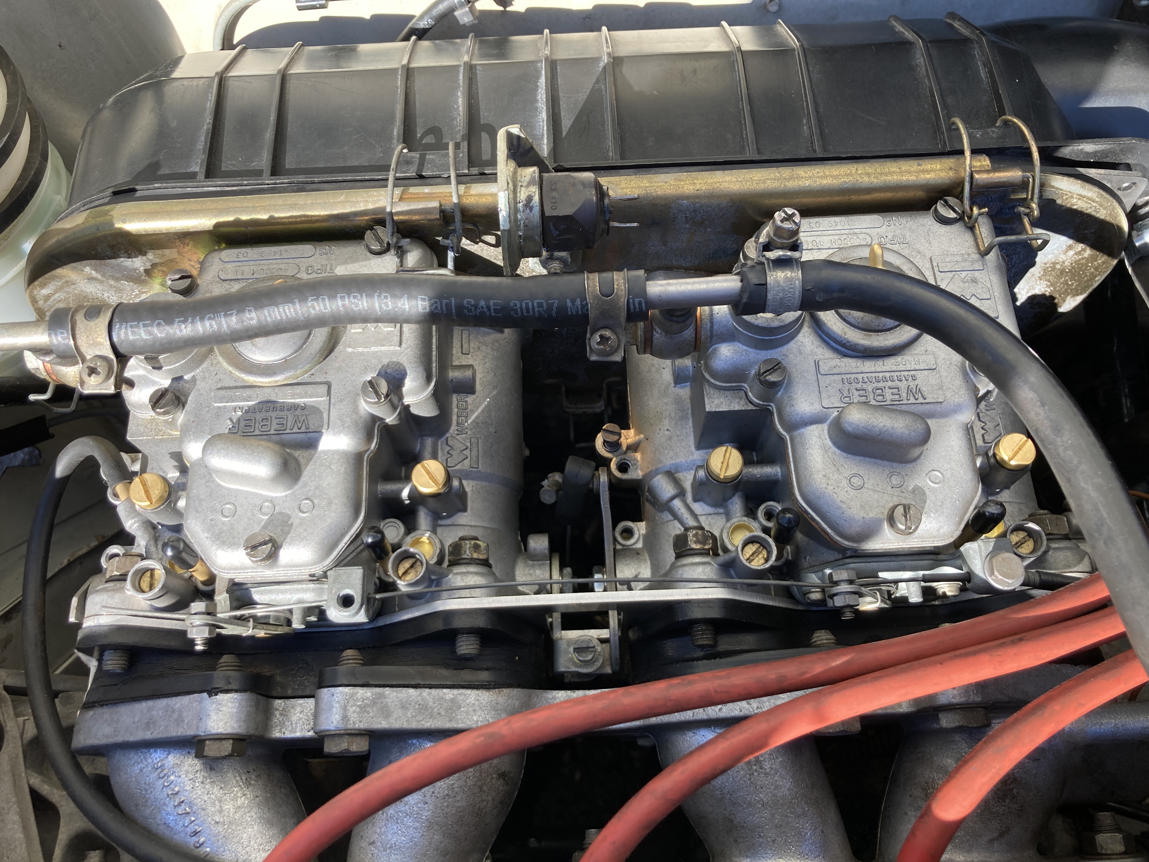

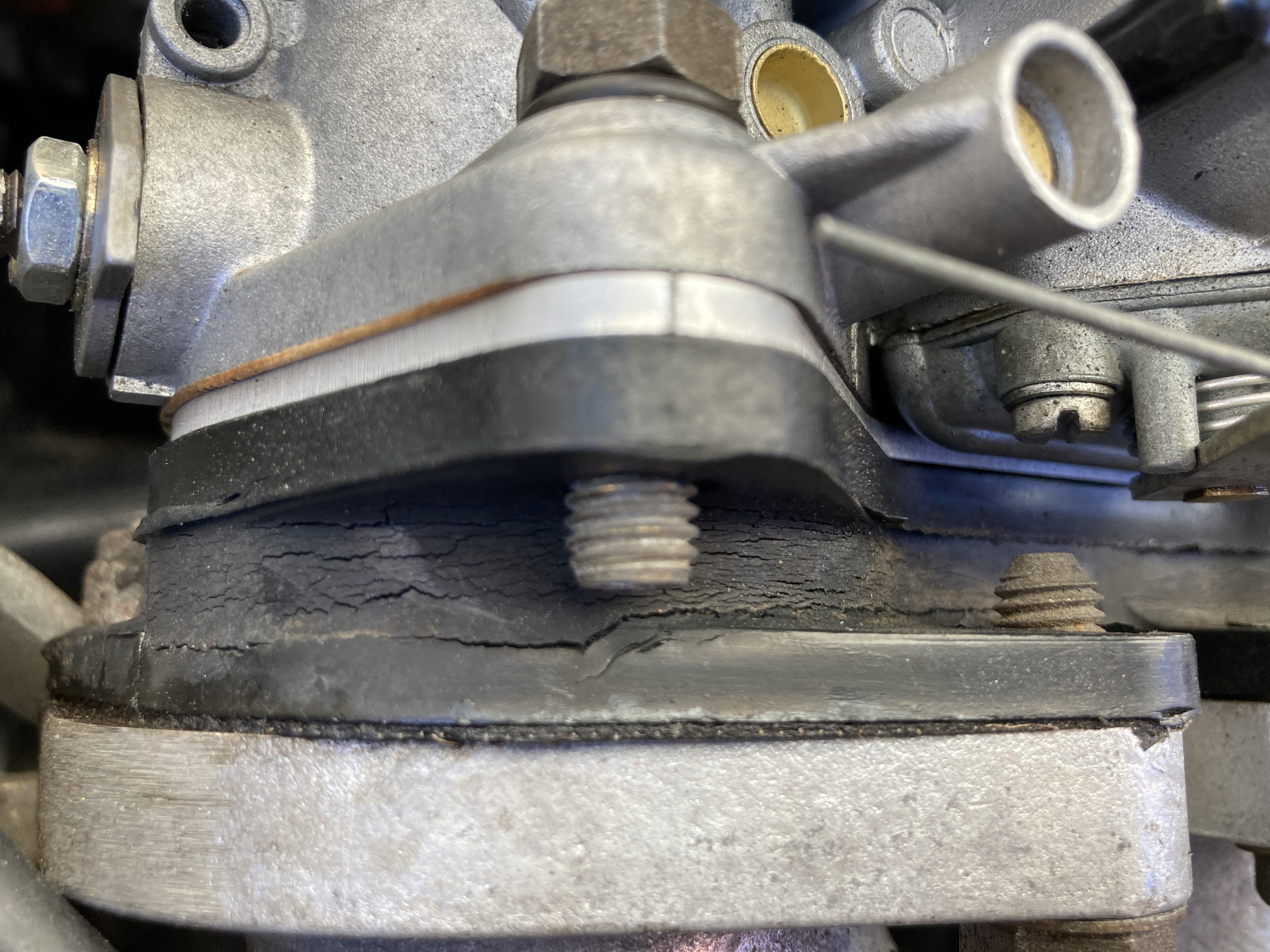

Depuis la reconstruction, la voiture roule fantastiquement... A part une chose, une GRANDE VIBRATION. Je pensais que c'était peut-être Cardan, alors j'ai changé cette pièce car le roulement n'était pas lisse. Aucun changement avec la vibration. Serait-ce les Weber ? Peut-être que mon bloc de montage en caoutchouc doit être remplacé par ces fissures ?
Since the rebuild the car is driving fantasic... Apart from one thing, a BIG VIBRATION. I though maybe it was the drive shaft, so I changed this part as the bearing was not smooth. No change with the vibration. Could it be the Webers? Perhaps my rubber mounting block needs replacing with these cracks?

The vibrations have multiple origins.
The poorly mounted clutch disc, for example, especially since you have just changed the gearbox.
Wheel balancing.
The age of silent-blocks, especially anti-squat.
It's not the cracks in the carburetor flanges.
Improper adjustment of the carburetors can cause vibration to the engine as well.

Thanks so much for the advice Jean. The car is driving great but the vibration sound in the cabin is really annoying.
The vibrations certainly seem to be coming from the Weber area in the engine bay and causing the vibration noise through the bulkhead and interior dash.
- At idle there is no vibration. But if I open the bonnet and push down lightly on the Webers then there is a vibration sound.
- When moving if I depress clutch there is no vibration sound.
- On throttle and off throttle the vibration sound will raise to the tempo of the engine.
- There was an occasion recently when cruising at 70mph in 5th gear the vibration noise completely disappeared for 15mins and then returned.
A new clutch was mounted with the gearbox rebuild and new engine / gearbox mounts were added and the engine and transmission seem very firm. The suspension was fully renewed with B6 and Eibach springs. Geometry was all set-up with a proper alignment machine.

the clutch release bearing ?
do you have the lower support bar of the carburetors ?
Butée d'embrayage ?
As-tu la barre de support inférieur des carbus ?
