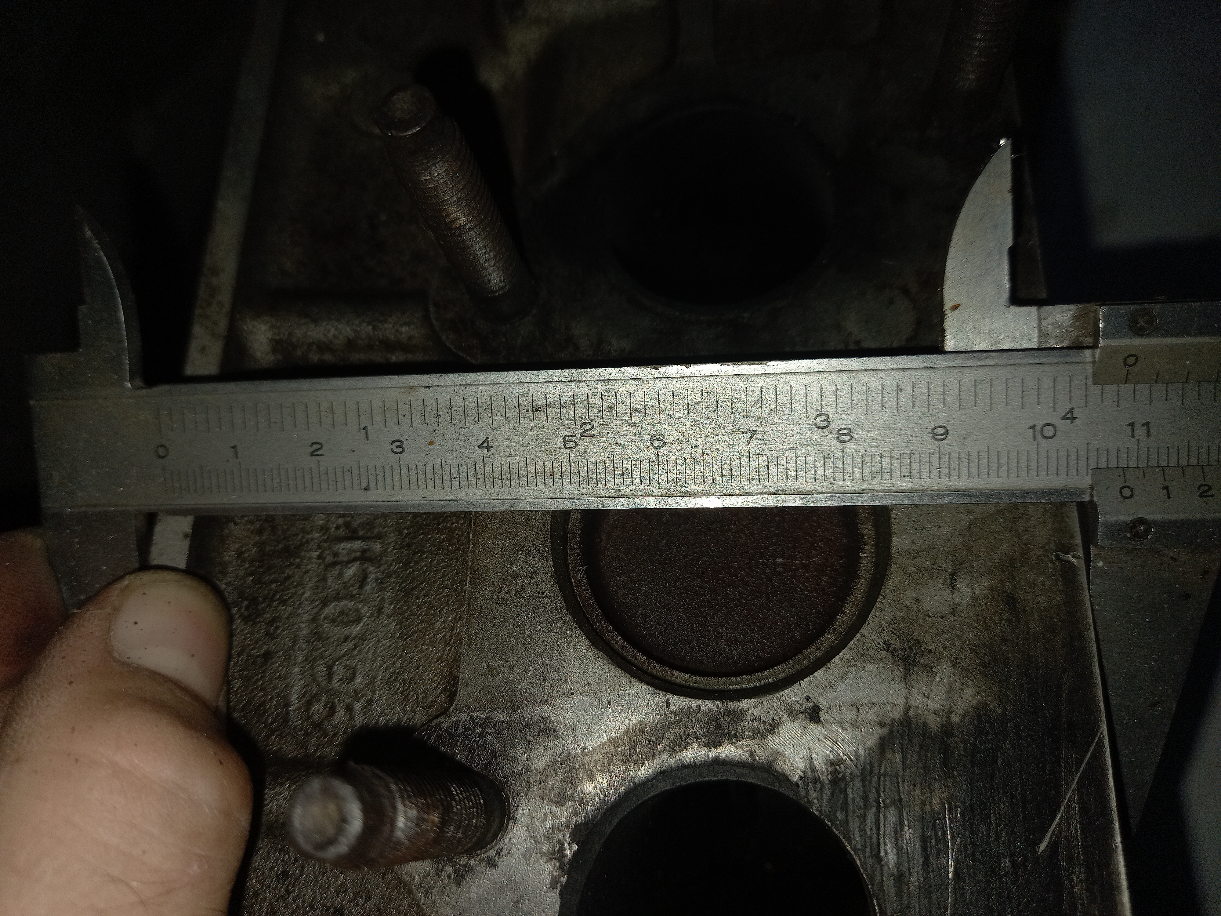

Hello.
Get a tu24 head which i asume was made for tu3 engine.
How many material still left? Ticknes now 108.5mm
Need again machining-have some stratches :crying:

Hello Guy,
The original cylinder head measures 111.2 mm.
Yours is already very planed. You can surely do a surfacing but no more!!
Do you have valve prints in your pistons? Otherwise they will touch your piston. "_"
Or you have to find a very thick cylinder head gasket

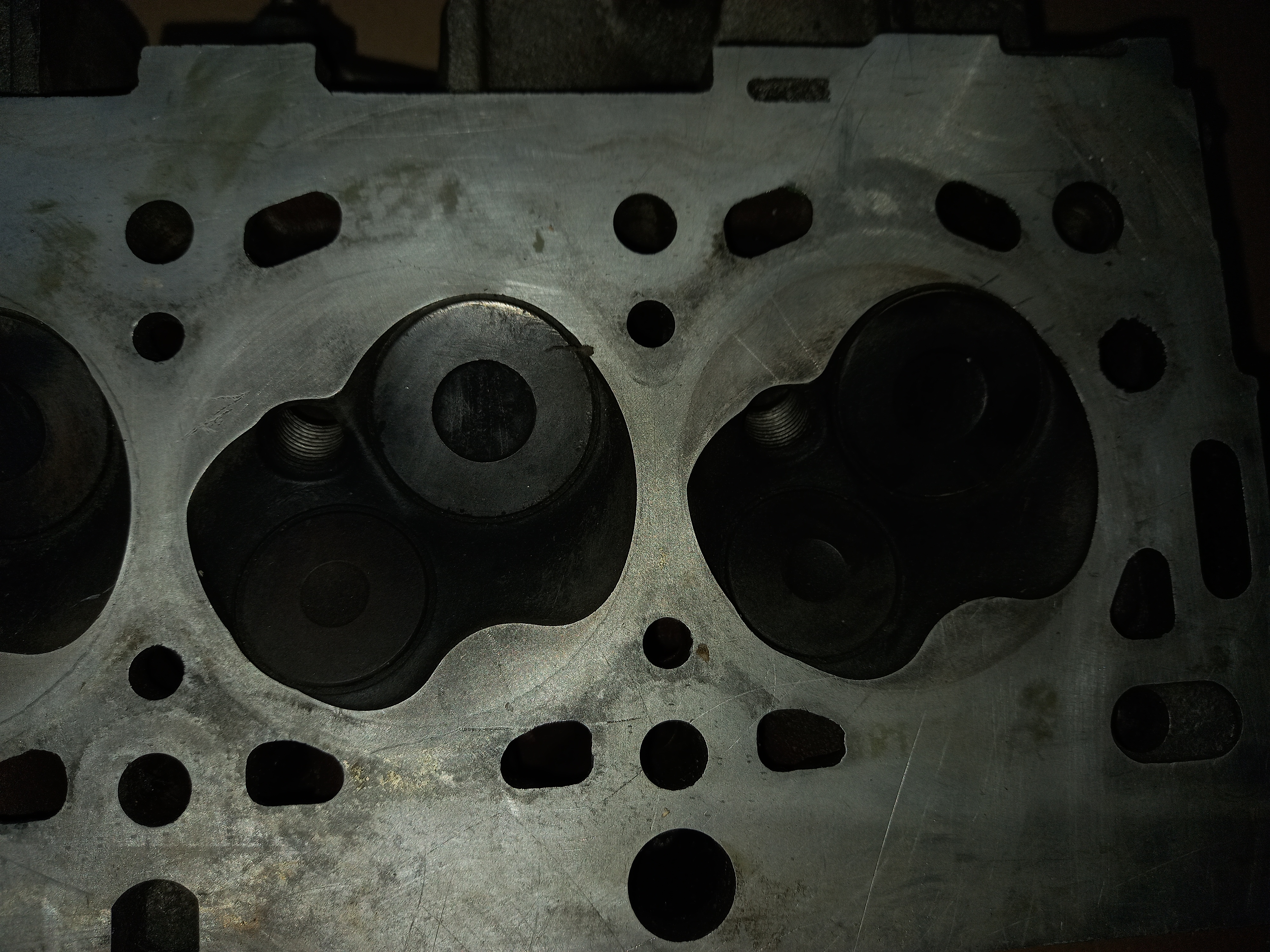

Botom end is original tu3 alloy -pistons are dished(have this hole on all surfyce).
Do you have idea how dip and on which position I need to machined valve prints?
Do you think that will tuch slso "static" with manual rotation of engine?

I can't answer these questions. :crying:
I don't know everything about the tu3.
