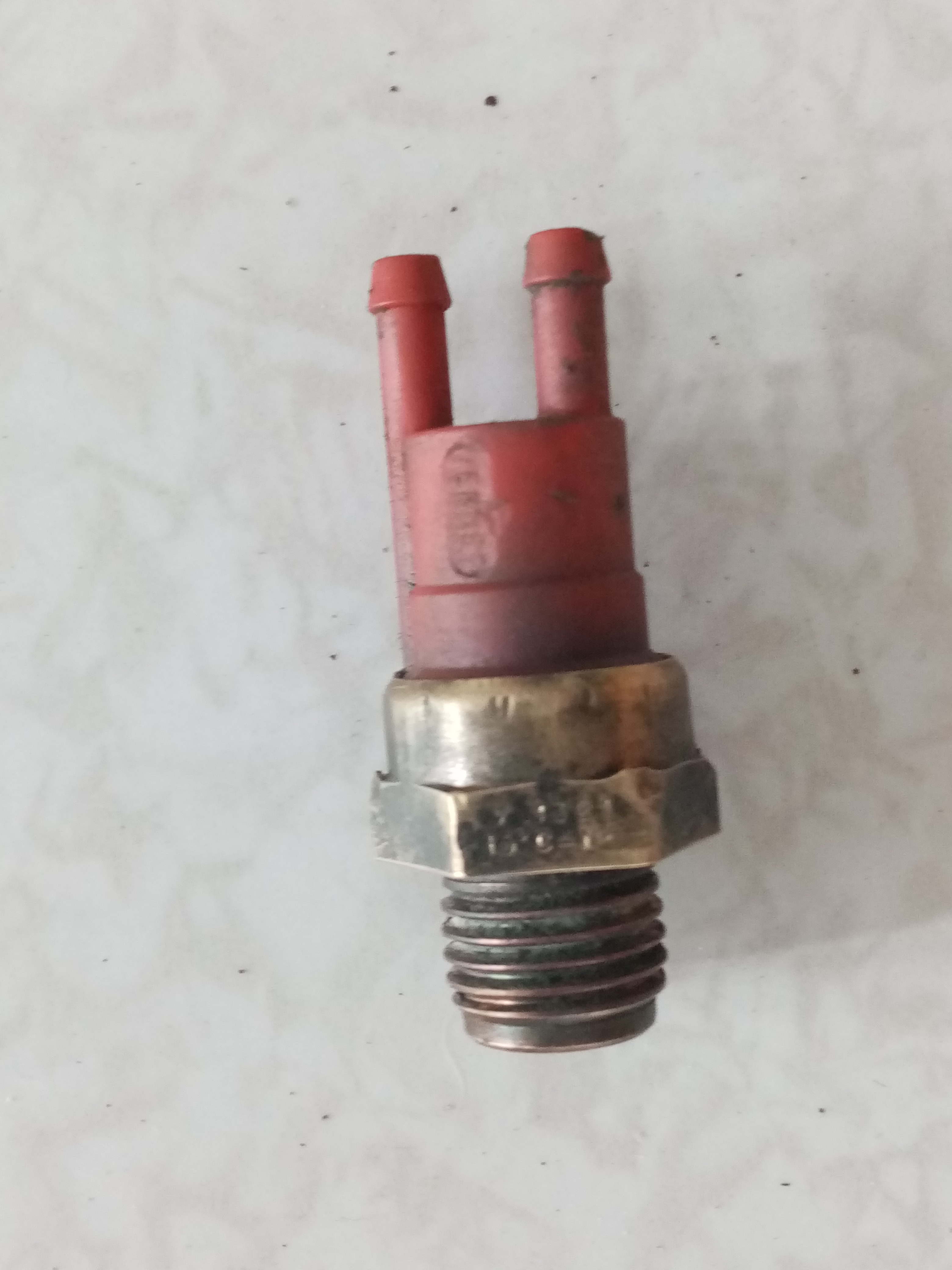

Hi,
Does anyone know if you can still get these switches that control the vacuum advance with engine temperature? It is the red valve in the picture.
What size is the thread fixing? I cant remove mine. I have tested to see if it works but I dont think it does. I have found some similar ones used on american cars but not sure if they would fit: https://www.musclecarsandclassics.ca/en ... -1976-1981
Thanks for any help :)
Tim

Hello Tim,
To help you, I give you the after market part number : 1621.58
Maybe you can find it by a web dealer or in "Avente Peugeot" store.
I make some research ...

Thankyou.
I have looked in a couple of places with that part number with no luck... suffice to say certainly nothing here in the UK!
Any help much appreciated! :ok:

Is that what you are looking for? I have one available.
Adishatz a tots
Claude

thiscocks1 a écrit : 17 août 2021, 18:30 Thankyou.
Merci
Not better for me :(
I continue to search ...

the thermostat (Part #12) seems to be available in Russia <_<
https://www.ilcats.ru/citroen/?function ... anguage=fr

Thanks, ill take a look. Seems like a tricky part to find.
Do you guys still use them on your cars or do you just bypass them? I guess it doesn't make too much of a difference if the ignition is set up correctly...
As I understand it only affects the idle speed when the engine is warmed up.
Thanks :)

I'm not specialist but it's an antipollution thermostatic valve so I think that the engine can work without it, just with increased pollution.
