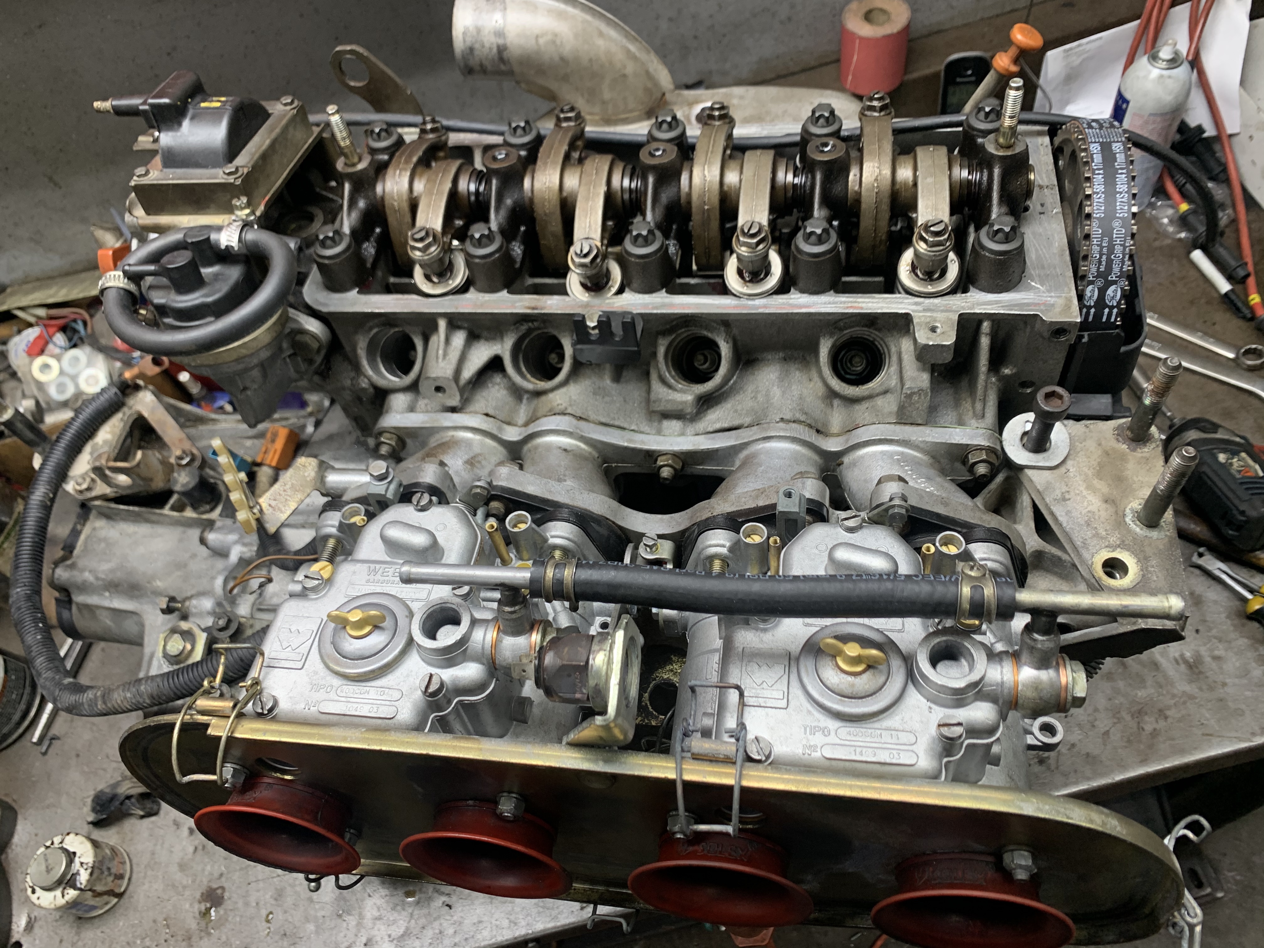

- My car is going to the mechanic who works on my Lancia Delta in 3 weeks. The plan is to assess the damage to the Rallye box - we do not know until it is open whether the 2nd gear cog is damaged or whether this is just a synchro issue... So, I have a rebuilt Saxo VTS box available as well because I hear the Rallye box 2nd gear is no longer available. Even if the 2nd gear is ok, is the best future longevity for the gear system to use the best parts of of the two boxes? Or should we just refresh the Rallye box?
In the first scenario I understand that the Rallye final-drive / differential will need to be retained if using the Saxo box.
- We plan to service the Weber carbs from the kit from the 205 Rallye club shop (thank you Francois!). The mechanic has experience with these carbs as he uses them on Alfa and Mercedes restorations. So he will also fix some incorrect plumbing that is on my current Weber set-up.
- I will fit B6 Bilstein and Eibach springs after reading the good assessment of suspension options on this forum.
- We will fit new belt, roller bearing and water-pump.
- When the gearbox and engine are removed from the car, what other components are advised to refresh when they will be easy to access? I will do the clutch. But are there seals, gaskets, etc that we should do while things are open?

Quelques photos d'hier avec un ami anglais!

Quel beau projet d'entretien.
Pense à changer les joints de vilebrequin, côté embrayage et derrière le pignon de distribution.
J'adore vos 2 européennes à carbu en Amérique.![Very Happy :D](./images/smilies/biggrin.gif)

Ma Rallye ? Toute démontée. ![Wacko :wacko:](./images/smilies/wacko.gif)

Like ced s says, don't forget the crankshaft seals
You can also check the good condition of the wire and the terminal on the oil pressure switch on the front of the block.
The valve cover gasket should be replaced after a rocker clearance setting, check the spacers between the valve cover and the rocker ramp are not broken (the plastic ones breaks when tightening)
For info if you don't have repair manual :
Valve clearance: Int: 0.008" (0.2mm) Exh: 0.011" (0.3mm)
Valve cover torque: 11ft.lbs (16Nm)
Concerning the gear box, I think the best is to first check the condition of your current gearbox. If it's just a synchro ring problem, you can just replace the bearings and synchro rings, clean all the parts and put some good sealing compound (Loctite 518 is perfect)
Keep in mind that this kind of cars keeps their value with their original parts![Happy ^_^](./images/smilies/happy.gif)

Re: Conseils sur la boîte de vitesses. Aider!
Gearbox, valves, head, Webers, rebuilding almost finished...
Boîte de vitesses, soupapes, Webers, reconstruction presque terminée...
![Ok :ok:](./images/smilies/enaccord8.gif)
